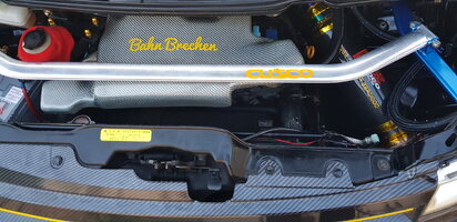

My induction kit, took a punt on it on the auctions in Japan as it was a good price knowing it was going to need a bit of modifying and not quite sure whether I could make it work and although it was advertised as being for a E51 it was clearly not
It is a Power Chamber Zero1000 who are the same company who also make the Satisfaction.
A bit the same as the Satisfaction intake that I have posted above but even more so as in it's original state it was miles too long and also had a curve in the pipework that was never going to fit in the Elgrand engine bay and even worse this was in the wrong direction.
Cut down and the curved pipework cut out and replaced with 45 degree alloy pipe with a new alloy maf flange fitted and a Samco hose with a PCV take off built in to the throttle body and the cone filter replaced with a HKS style 200mm mushroom filter which gets a bit more air in but also reduced the length of it by just enough to so that it fitted in the Elgrands engine bay.
All the alloy pipework and silicone hose is wrapped in gold heat resistant tape and hoses held in place with some quite nice T bolt clamps all of which I got from Aliexspress for not to much money.
Will be building a custom alloy air box around the filter with 2 80mm cold air feeds in from the front bumper at some stage
Tight but just about fits and more by luck than judgement the mushroom filter is pretty much in just the right place to get maximum air into it when the cold air feeds and air box is fitted.
Sounds pretty good now with Elementian's 18 inch silencer that I have had fitted for quite a few years now and I have found after playing around with it a bit that if I set my throttle controller to S5 it gives a good balance between a nice deep growl at idle with a pretty instantaneous gulping sound when the accelerator is pressed and sounds quite aggressive at higher revs.
Hoping that when I fit the cold air feeds and air box and the plenum spacer that I have bought this will improve the sound a bit more.
Most likely not that much faster if at all but definitely feels a bit more responsive and more fun to drive although this could possibly be down to the Impul ECU that I fitted at the same time rather than the induction kit.
This is it now fitted in my engine bay.
How it started out when I bought it from Japan before the curve was cut out and replaced with the 45 degree alloy pipework and the cone filter replaced with the mushroom filter.
You can gauge how long it was from the tape in the picture.
