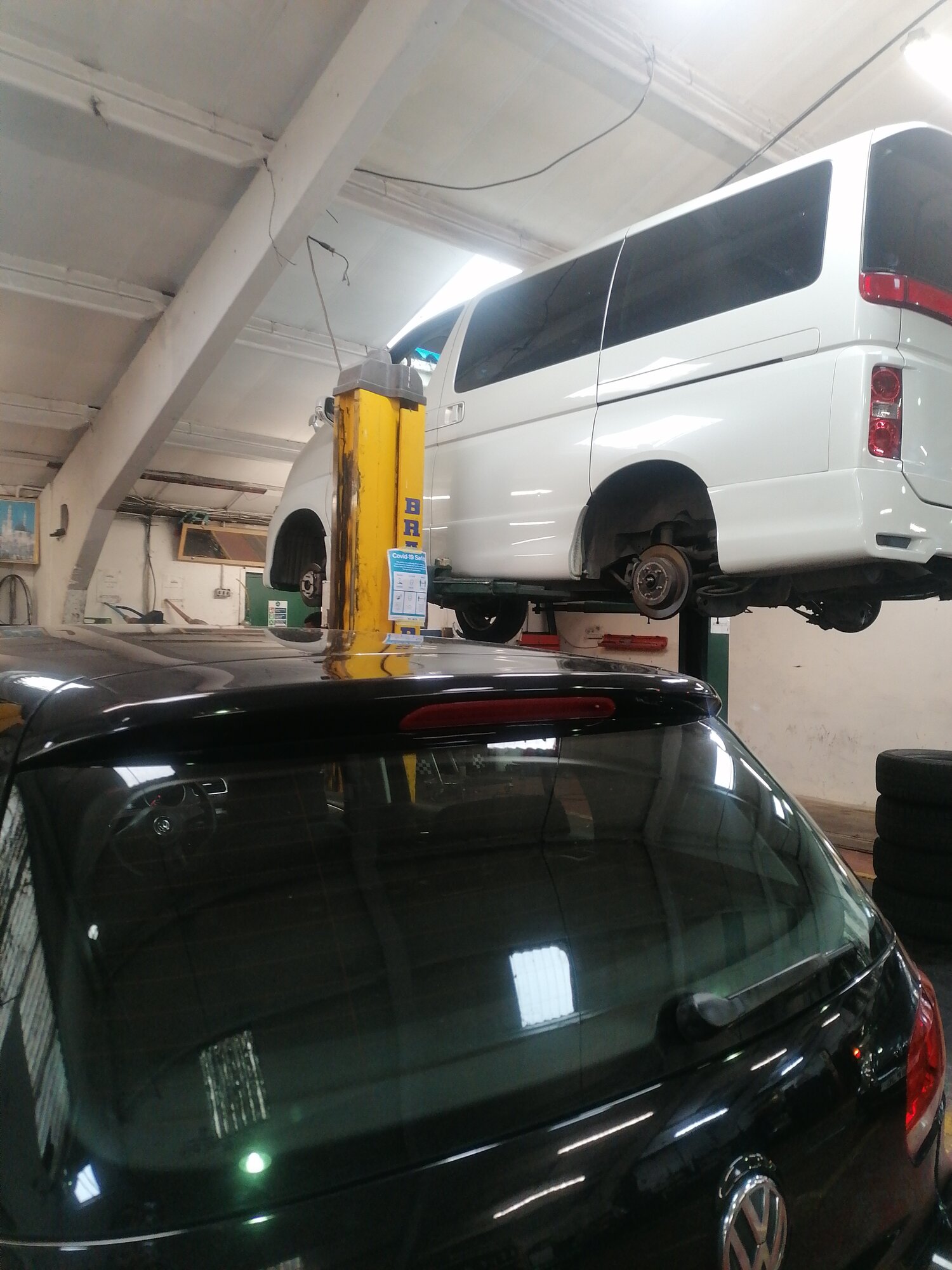

Does one know how many spacers are required after de coring front cats...car is up on a ramp as i type.

What spacers? Don't fit any spacers to front lambda probes.
Hey @Lpgc There are apparently 4 sensor 2 before and 2 after. The question from the garage is does any spacers need to be fitted on the two sensors before...as this is normally not the case.......
So to clarify the spacers go on the lambda sensors after the front cats?
Definitely don't fit spacers on the front probes, this should never be done on any vehicle under any circumstances.
No need to fit spacers on the rear probes either but it won't hurt to fit a spacer on the rear probes.
