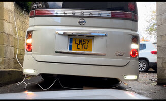

Hi All,
I have a HWS and in the rear bumper there are 2 blanked off areas...one on either side.
I'm guessing they were possibly some type of lights on a different model and wondered if I could buy replacement to turn in extra reverse lights...or even one that could be adapted to fit there.
I commented on a recent rear camera thread and mentioned its piss poor in the dark and went on to ask if it was because one reverse light had been done away with for the fog light.
I was hoping to add extra lights and wondered if this was feasible.
Thanks in advance.

From what I can tell they fit the aperture (I held them against the opposite side to check). They have a stepped edge so plan was to cut a whole smaller then bond them in to the bumper. The picture on my build thread is of them fitted in a HWS bumper and they look like they fit and look factory fit. @JDM Elgrand has had them fitted and recommended them.
That's a hell of a lot of work when there's a much easier solution which involves no modding of the bumper.

@JDM Elgrand posted these https://amzn.eu/d/0DfCONT on my project thread have a set waiting for me to fit in the warmer weather.

I bought the lights & got them fitted while having pop top fitted. Straight forward & looks ok.
I’ve put an eagle eye fog light in the recess .. I had the same problem not being able to see jack on the winters night when reversing.. changed both my reversing lights to brighter LEDs and change the settings in the rear camera .. can see clearly now in the darkness..IMG_1108.jpeg
